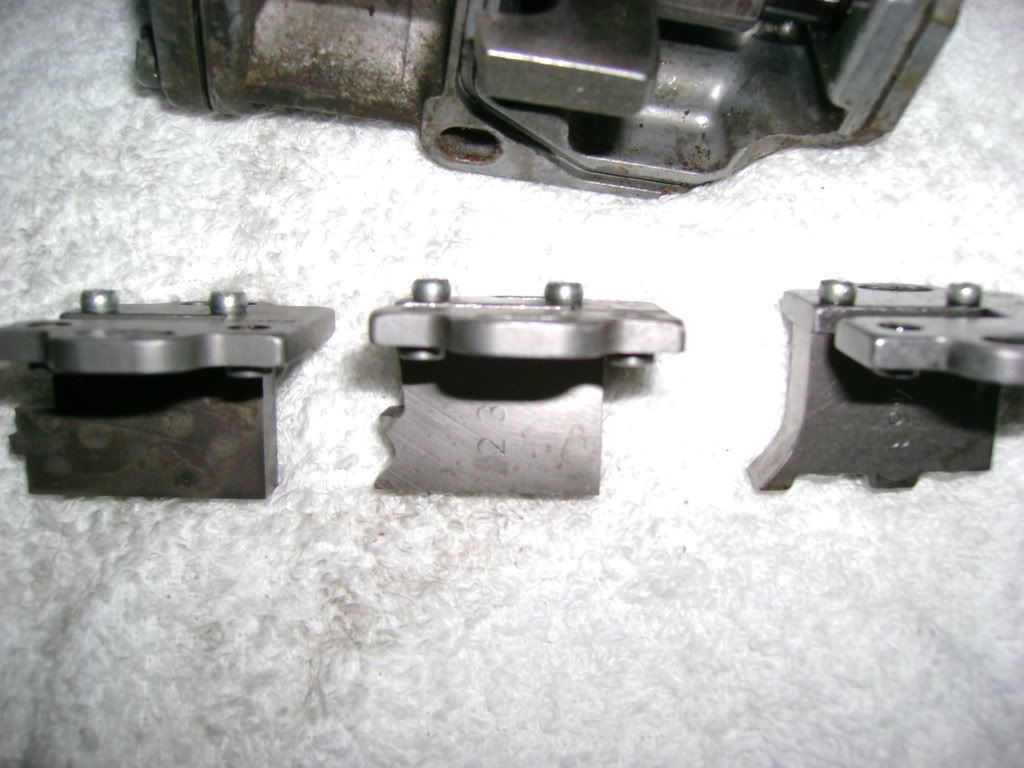

Once significant boost is built the AFC allows full fuel and the governor arm is free to ride on the plate. Moving the plate forward or using a different one would allow the governor arm to travel farther and increase rack travel effectively increasing the duration that the fuel is injected. Because boost is already built and most likely the rpms are high enough, (hopefully your setup doesn’t allow full fuel before the engine is ready) the aggressiveness of the plate usually has little effect on smoke levels especially with stock injectors and turbo. This is where max power happens though so an aggressive plate is usually desirable. Leaving the pre-boost screw backed out and sliding the housing to the desired pre-boost fueling is a good way to compromise the max travel without giving up unwanted low-end smoke.

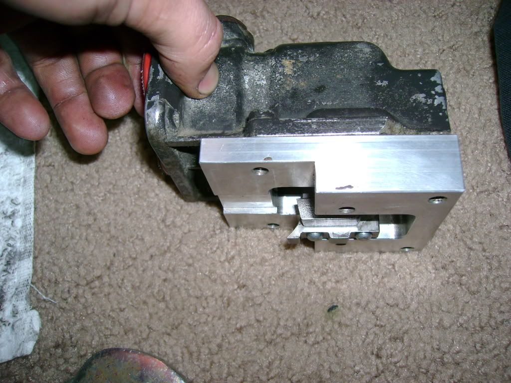

The stock AFC doesn’t always incorporate enough travel to obtain full potential rack travel. Modifications can be made to allow full travel but some may give up a little ability to limit smoke. Careful choice is required. Switching the washers that hold the diaphragm allows additional travel but will not allow the arm to return to its home position and will be like turning the pre-boost screw in a few turns. I prefer to use a modified washer, to replace the cupped one, which allows both. Another common practice is to grind the tip of the AFC foot flat (only take off the angle do not grind any more than you have to, I ground way too much on mine and the smoke control suffers). Some instead like to add a small washer between the back of the diaphragm washer and the rod that controls the arms position, and grind the forward part of the arms barrel.

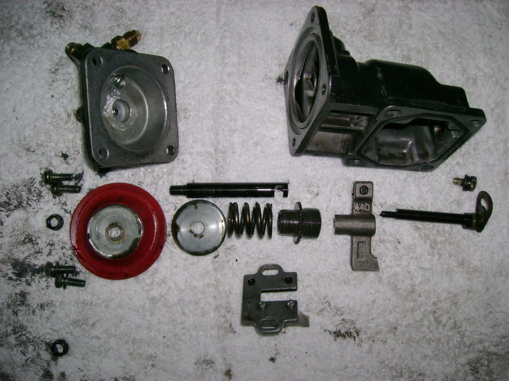

Once you get the AFC off the pump, it’s very easy to dis-assemble starting from the rear. I replaced all of my mounting screws with M6x1.0x what ever depth is required for the situation from ACE Hardware.

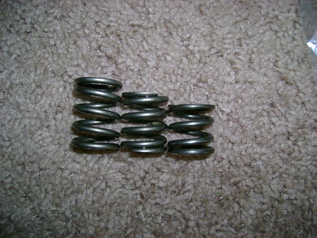

Stock governor spring, stock 215 spring, and #27 wire

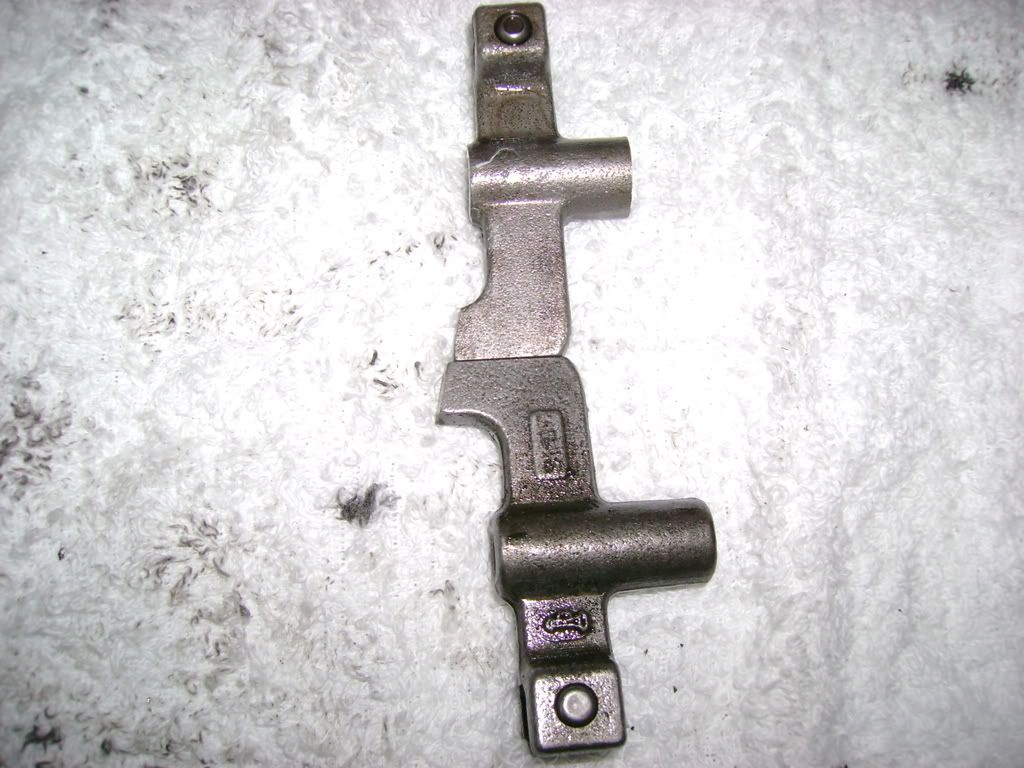

This picture shows why grinding the foot or adding a washer and grinding the barrel is needed
