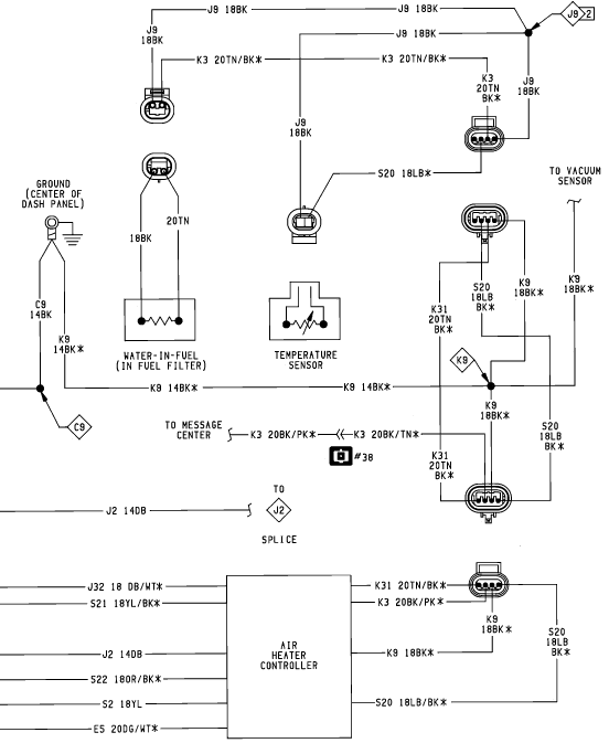

i need help finding an engine wiring diagram for a 12v 6b(no turbo....hoping im in the right forum) the engine is in a crane that was a repower and the company that did it(before i got it) replaced all the wires with white ones and half of them arent connected....and the worst of all someone removed the engine plate so i have no serial number any help is appreciated.

I am positive, that the wiring diagram is different, as only 6BT s came in these trucks. What specifically are you looking for? How to make it run? Whats it doing?

for some treason we have a scavanger that is killing the batt. but all the wires got replaced with the same color and half arent connected and i dont even know where to start so i would like to rewire the whole engine how much wiring is really for the turbo/how different can they be?

Heres the 4 diagrams I thought would be most useful. They are for an 89 W250 with the Cummins Diesel Engine (6BT) Hope it helps.

ok thanks man we will see what happens
