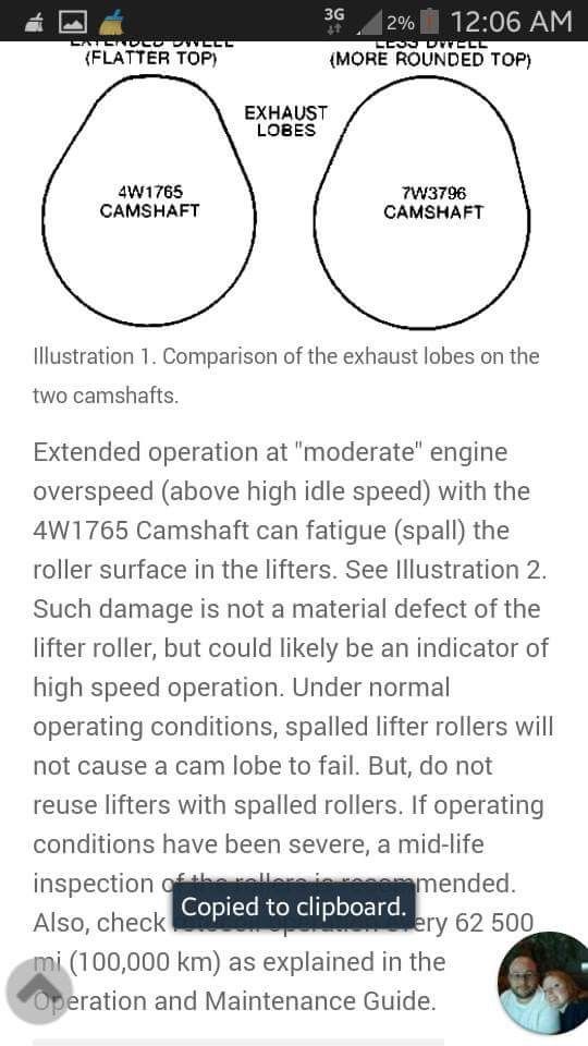

Before changing engine cam it is best to figure out what you are running.
As for nozzles that's another one, depending on piston you are running on if the upgraded would be feasible, I would not try running 8789 nozzles on aluminum pistons. They are around 30% more flow then a 8785. I can tell you there are a handful of generator set engines that make 603hp at the crank with 8785s on factory pump settings and 1800rpm limit.
