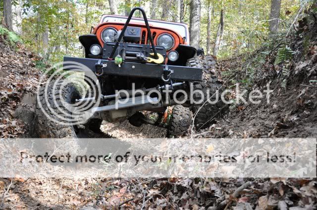

This is a project that has been in the works for 2 years and has finlly come to life.
Loaded with Chevy sb 350 that was built for a circle track raceing toped off with Holly Pro Commander 900 4 barrle throttle body , TH 350 trans with a manual valve body built for sled pulling, Doubler t-case setup with front half of a np241 mated to a twin stick D 300, Drive shafts from HighAngle Drive Line , Dana 60"s front and rear with 5:13 gears, Hydrulic steering form PSC, and too many "custom" mods to get into. Now I have to change my Avatar!!!

This was the first outing and every thing went well. Can't wait to get back to Hot Springs and put it on some rocks.
