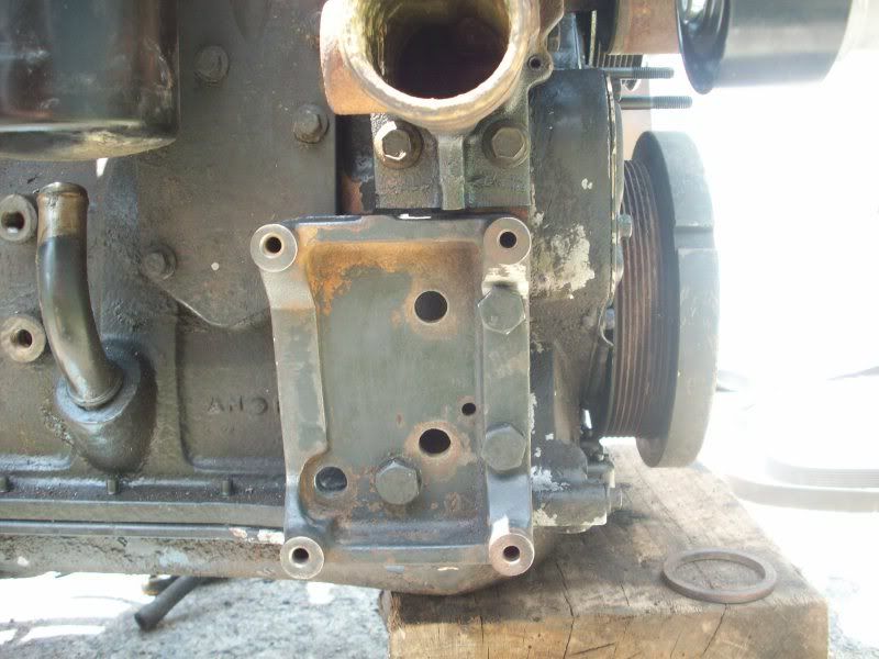

New to me 12v with 143k
Then i cleaned the motor did away with the stock lifter pump and other things. Built the alt and a/c mounts.

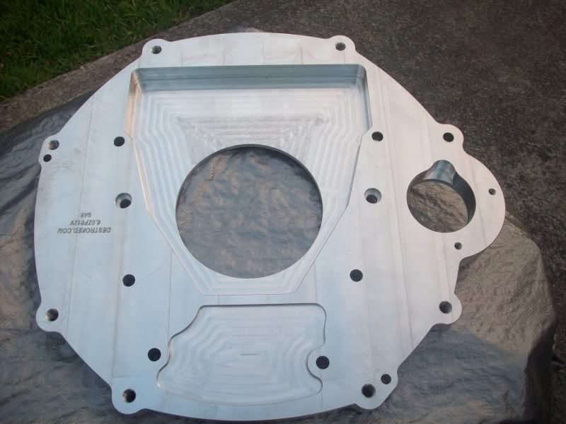

Next i got the flywheel from a friend and got the bearing put in by a machine shop. I called south bend clutch and the man that handles all the engine swap stuff told me this is exactly what they do. It is a 6205 bearing and just about any bearing shop or oreilly's has it. At oreilly's its more expensive and the part# number is a 205FF.
Finally my adapter plate came in from destroked and i was able to drop the motor in place.

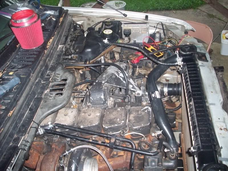

It really was not as bad as i thought. It took me about a week from start to finish all i did prior was pull the wiring harness and build it up. The only thing i have left to do is the down pipe waiting on mine to show up.

Next i made the throttle linkage, hooked up the power steering pressure and return, and connected the stock 6.0 fuel lines to the cummins fuel lines. Im using the stock ford fuel pump.
after that i got rained out so i built my harness and found some hot wires with the key on for the elec. fans, FSS, And grid heater relay.

Ok so i put my downpipe together this morning and drove the thing around. I cant get any more boost than 2 psi. And when it hit about 2.5 psi it bogs down and blows white smoke?? The only mod is the afc housing is slide and that was by accident. Also i am not running a wastegate actuator. mine was broke so i took it off and wired the little arm that comes off the housing in the up position? My turbo is flipped. I really dont know to much about these motors. Any help or pointers. ive read the tech. articles but that really doesnt help me to much sorry.
I think i wired it shut but ill check on that when i get home. I can floor it and it runs great then bam it shuts down and pours white. Also what does the motor do when it defuels at 2200 rpm and what does it do at 2800 rpm that is stock cut out right?
