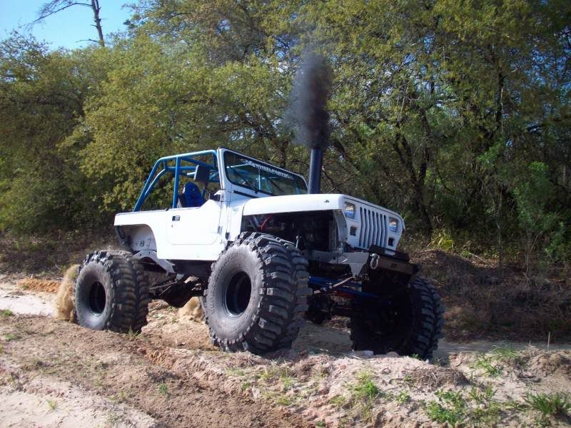

NOW I like that! give us some specs and more pictures Please. that thing is so hot I would sleep in it at night!!!:haha what axles ,eng, tranny,tranfer case?:thumbsup

dana 60/dana 70 w/ 5.86 yukons, detroits, discs, etc.
4BT cummins w/ pumped turned up, K&N filter, hoodstack :D (gunna get POD injectors and a bigger turbo)
nv4500 w/ centerforce clutch
dana 300 tcase w/ teralow 4:1, hd 32 spline output shaft, currie twin sticks

:woohoo thats awesome. Are those 44" swampers?

What do you do with it most, swamps? what kind of terrain is neer you? do you have some action shots you can put up for us?
well i built it for rocks, but as we all know, there really aint many rocks in FL. i still use it for mud though. mud is mainly whats around here... it could be used for rocks, mud, sand, hills, daily driver, etc!
