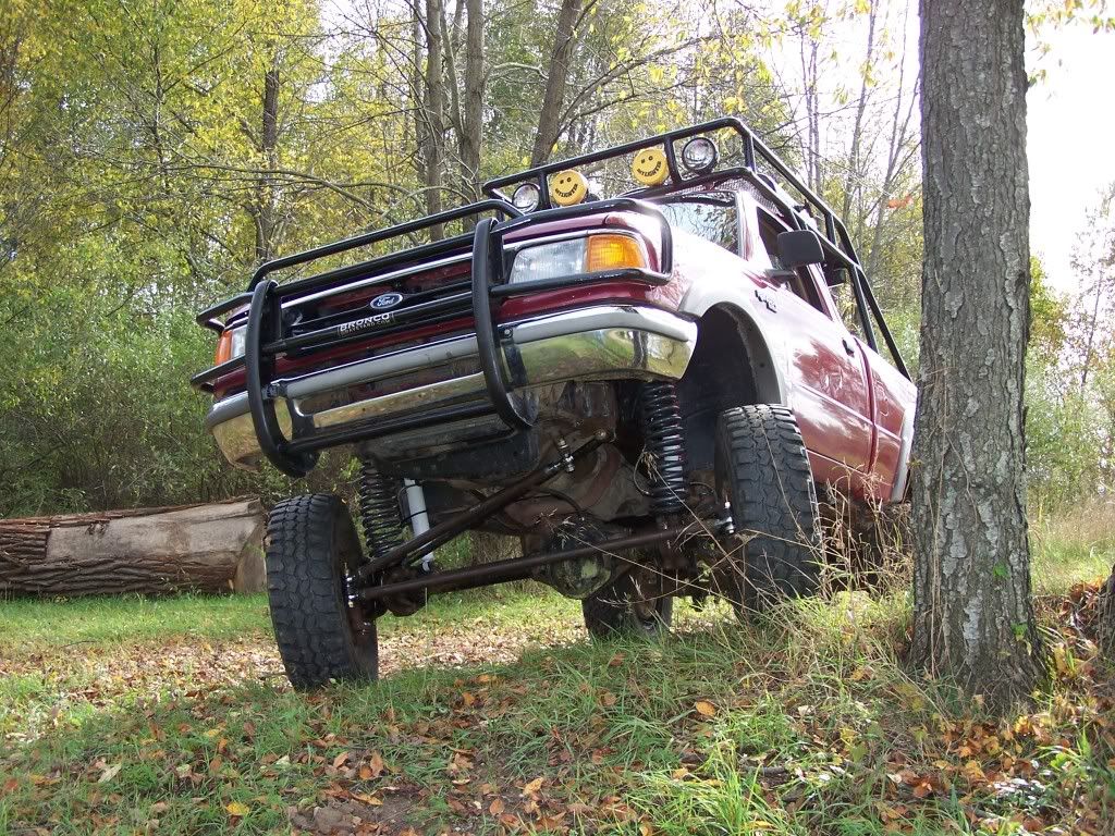

Heres the truck.
Still working the lack of tire size. The truck has a solid axle out of a 1976 f-150 with 3/4 ton outer knuckles so ya is a 8lug ranger. The axels has a 4.88 ratio with a limited slip front. The rear axel is going in in two weeks that is a corprate 14 bolt with 4.88 gears with a detriot locker. Fuel injected 5.0L is coming soon.
I now drive a Duramax...
318 Posts
It's going to be hard to put it in 4wd without a front driveshaft:knight
163 Posts
That was right after we got it done the drive shaft had to be cut and shortened. The rear axels is being put toghter right now. So it should be in in about two weeks.:thumbsup
the placement of the springs sucks. should have mounted either farther in on the frame or farther out on the axle. id like to see where they are pointing when its articulated.
163 Posts
The bottom coil retainers always bend down because they are stock. They are captured top and bottom so were are they going to point.

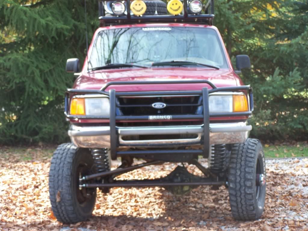

Heres the ranger with 35" procomp xterans.:thumbsup
I will get some better pics soon.
looks good. should be a fun little off roader.
