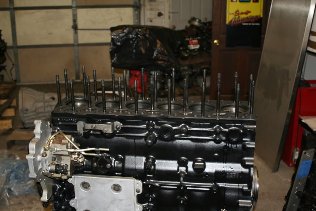

Got some photos from Corey @ Sasquatch today and all seems to be comming along good. Looking to have it back on the road in early April, needless to say I'm getting a bit itchy. I cant say enought about the professional work/attitude Corey has had during the entire process. Thanks man!!!:thumbsup
