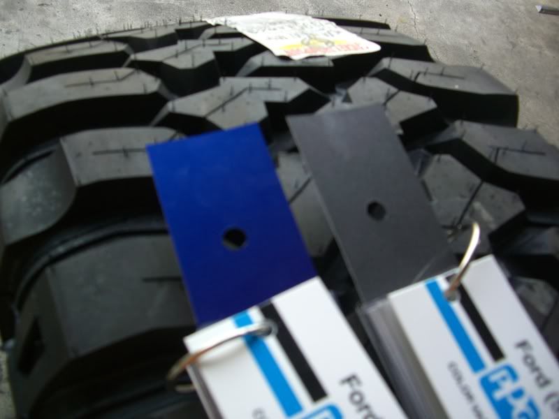

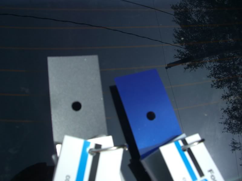

Finally picked the colors out also. Hard to see but I think it will be SWEET
Ford Sonic Blue
Ford Medium Platinum Met
