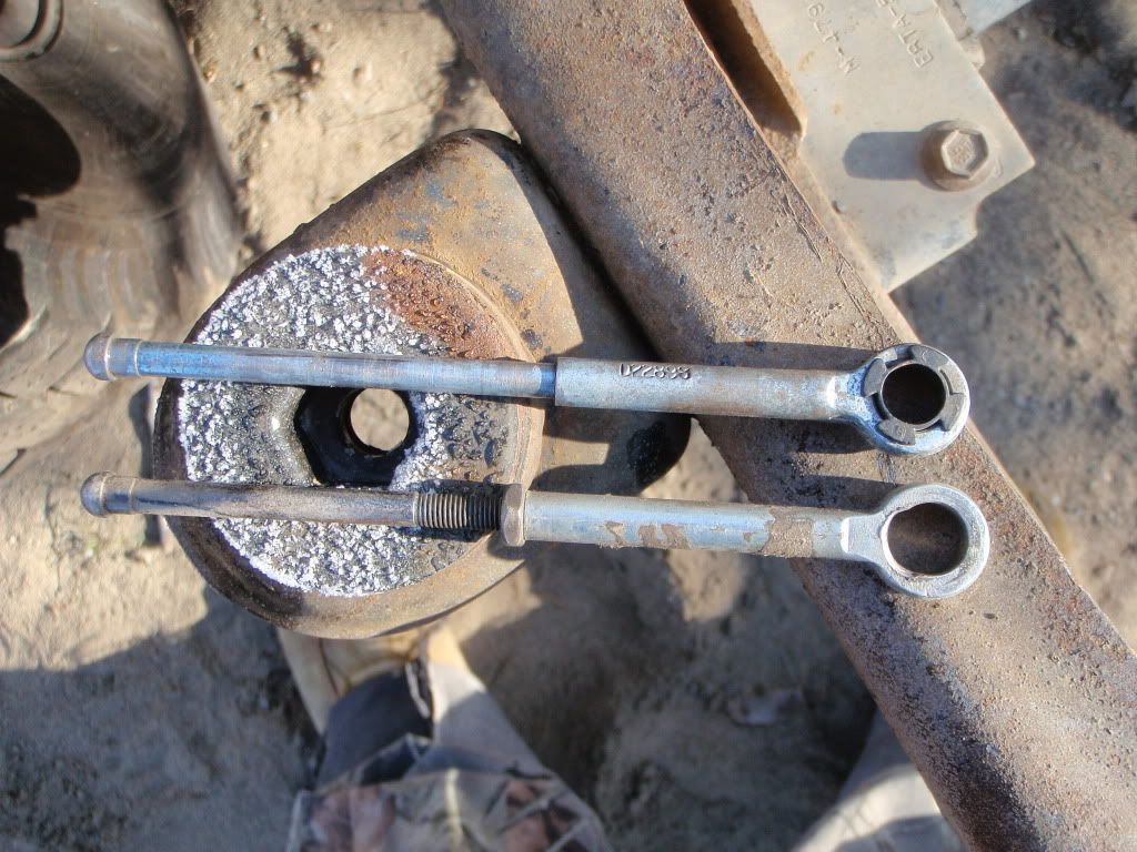

* You have a worn bushing and the clutch actuating rod going into the MC falls off repeatedly. Buy a new bushing and install. 5 minute repair
* The worn bushing is missing from lots of neglect and now you have worn the clutch actuating rod eye into an oval and subsequently you have less and less ability to engage the clutch often thinking this is a worn clutch disc symptom.
* The clutch rod now very oval has now worn a massive amount from the pin and you have little to no clutch at this point and encounter grinding and poor shifts. My clutch pin was almost worn completely in half.

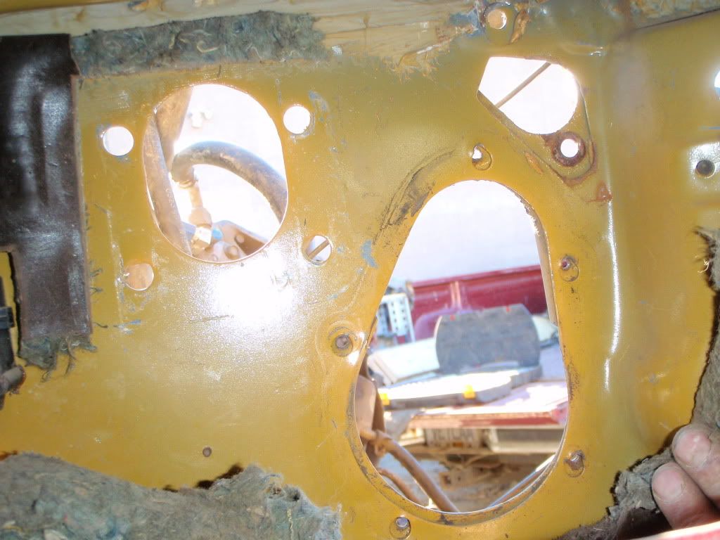

With everything out of the way (pedals and column)....and yes I did cut and remove some of the firewall insulation as opposed to just moving it out of the way. It as it was coming apart anyway which just makes it simpler for me. See, this is about what you should be looking at by now.
And this is the view outside the vehicle where the steering column, clutch MC and brake booster MC where.

As you can see here by the scuffing on the firewall/trans tunnel area, I did some minor massaging of the metal to let the plate sit correctly with a hammer.
Now I have made a few more minor tweaks, some more to the firewall and also subtle tweaks to the plate and now I have it right about where I want it.
